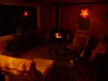

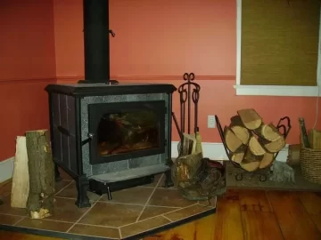

I was reading some earlier posts (learning) and I was surprised that some close their flu damper all the way. I thought that that would close the flue pipe off completely. I always had mine 1/2 to maybe 3/4 closed at times to bring down the flu temp but was afraid to close it any further thinking I would lose the fire and smoke up the stove etc. Now I tried nearly closed and wow what a big difference. Now I wake to at least five degrees warmer and am using less wood. Is there a hole in the flu damper to still let draft through when shut ?
Another question I have is under the front of my stove is the primary air intake slots. I noticed that when I close the primary air damper all the way, air still gets through the slots (but restricted of course). I noticed that the primary air cover on the left and right sides are slightly bowed out. I can take my finger on each bowed cover and push them inward against the slot to completely shut off all primary air. Is this the normal ? just the design ? or are my primary air covers warped outward.
It's been a few weeks now and I am just loving this stove and wood burning 24/7. Boy will the oil guy be in for a surprise for his next delivery. My cat lays on the chair and doesn't move all day. I have to check him every once and a while to be sure he's still with us :-) If you look closely you will see him in his sual spot. And I thought the Mansfield didn't have a CAT !! :-)
