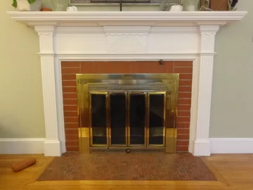

I'm new to this whole insert game.
Just bought a smaller home (~1,000sqft on the main level and a little less upstairs) with oil heat and would really rather not pay that bill every year. The ROI on a CNG conversion isn't there - nor am I interested in relying on a single heat source, environmental impacts, etc.
We're looking at inserts for the fireplace and have all but settled on the Lopi Cape Cod Insert.
Biggest concerns are this:
1) It appears we may be 1-2 inches short on the "combustible clearance" requirement from the ground up (36-7 inches versus the required 39). Is this a big deal? Do we really need to alter our mantle in some way? Is this a fire hazard danger or does Lopi overestimate?
2) Is the blower really loud? The concern is it will be an overpowering noise throughout the winter.
3) Do we need a dedicated juncture box in the fireplace or can we run an extension cord down through the back of the fireplace to the clean-our door at the base of the chimney in the basement?
Of course the capital outlay is what's having us be super cautious.
Here's our set-up:
[Hearth.com] Mantle clearance and blower noise concerns - Lopi Cape Cod Insert
Thanks for any help!

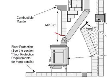

The 36" requirement is from the stove top to the mantel. It needs to be respected. A possible solution would be a mantel shield attached to the lintel as shown in red here. Ask your Lopi dealer if this would be acceptable. If so, one can be fabricated and painted (or made out of a decorative metal like copper), then installed. The blower noise should not be an issue unless run on high speed all the time. Usually this is not necessary.
Thanks BeGreen. The Cape Cod is actually a flush steel insert versus a cast iron stove.
My understanding is in this case the measurement is floor to combustible mantle?
It sounds like you're saying, regarding of that fact, even an inch or two of 3/4" thick wood on the mantle is too much combustible material?
If so then bummer!

The fireplace is a favorite of ours too, the mantle molding in particular.
If you're looking for an insert, from what I've been told steel inserts (like Lopi) require less clearance versus the cast iron inserts like Jotul.
Sorry, I was thinking the freestanding Cape Cod. Why Lopi ever gave the same name to very different stoves is beyond me. The solution is the same. Install a mantel shield to protect the facing molding. If the actual mantel projection (where it is more than 1" deep) is over 41.5". Then you may be able to use a shallower mantel shield. Ask your dealer about this solution.

I just went to the dealer today.
A) The blower fan noise is virtually undetectable except when it's on high.
B) The dealer came up with an acceptable solution to address the fact we're short 2-3 inches on the needed buffer for combustible material. Since the top of the Cape Cod insert surround protrudes several inches, he is going to have a piece of sheet metal cut that can be fastened to the top of the surround with high strength magnets. The metal will be painted the same color as the insert/surround. The magnets will be stacked two high, creating the needed air flow channel between the surround and piece of metal.
This will accomplish multiple things for us:
1) Meets code
2) Protects our white painted molding from heat and discoloration
3) Is removable whenever we wish
4) Does not require us to compromise our molding
Problem solved. I don't know if all Lopi dealers are this good, but these guys were great and spent a lot of time with us to figure out a solution. And that insert is nice looking.
Bring on the wood heat this winter!
Thanks everyone for weighing in.
There ya go. A mantel shield is a common solution. It's good to hear the dealer is helpful.
