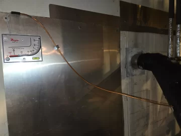

Should have been more specific. I mounted mine on the snap disc side of the return duct going into the back of the furnace. It was easily visible when leading the furnace, or when checking on the flue.
It was an older Caddy so the way the duct work is connected is a little different than the newer ones.

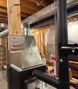

A couple of quick questions. How does this install look? Should I zero it out after I have everything set up and no fire running, or zero before putting the copper wire and tube on?

That looks good.
Zero it before hooking it to the chimney, then once it runs for some time and everything in the room is up to "normal" winter temp, pull the tube and check zero again...might be a hair off, might not. I know mine changes a bit.
Once its set, you generally don't have to adjust it again.
It is good to pull the tube out of the stovepipe and clean the soot off it once in a while...kinda gets covered up.

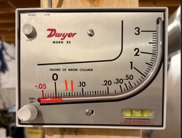

Thanks. I know this may be a dumb question, but in the Drolet manual, it says to be at -.04 to -.06. Does this mean that I want the red dye to go down and to the left?
Not dumb at all... actually a great question. Normally, yes, to the left for negative pressure like in a chimney, but, if you hook to the right hand port instead, it works just the same, but reads to the right, and will give a much great range, and easier to read in my opinion.
Reactions: sloeffle
Glad I asked and thank you for the clarification. Just to make sure I am still reading this right, I am assuming that to be at the numbers above based on Drolet, I need to be between the red lines?

Yup, you got it!
Thanks everyone for your help. After getting this installed I was running my HC hot. I am running right between .04 and .06 when I have a good fire going. I may bounce above for qucik minute but I can't adjust my damper any lower. I was way off on where I should have been. Getting better burn times out of my wood now. I Feel the exhaust pipe is not getting as hot as it should but I will monitor that closer as I was running around alot yesterday.
