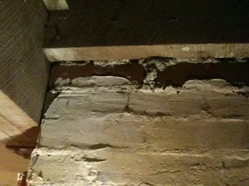

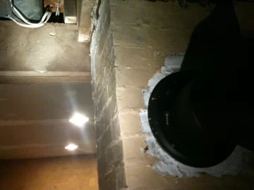

The ss flue has a terra cotta chimney liner and then the 4" brick and then the beam and joist. The beam is against the brick and the joist almost touches, the other joist and cross piece have an air gap of about 1". I put in pictures that shows the joist and the beam.

This does not look like anything to worry about. A SS liner with proper insulation and 4" nominal masonry, such as a brick has a 0 clearance rating. Plus you have flues inside the chimney. Nothing to worry about. This is a very commonly seen inside homes. Consider yourself safe with the chimney liner.
well yes most liners with proper insulation give you zero clearance with 4" moninal masonry between. my question is if you didn't have room for insulation blanket how did you get 1" of pour in insulation around it which is what most liners require for zero clearance?. the old clay should have been taken out to allow for either wrap or proper pour in insulation.
I installed 1/2" insulation on my liner. Once you get the blanket and mesh screen on it get pretty thick and hangs on everything. I would think it would be easier if you had a tight fit to get an 1" of perlite in rather than a 1/2" blanket.
