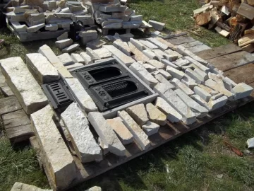

I'm building a masonry heater. I know I have enough fire brick for the insides but I'm not sure if I have enough stone for the outside. So I laid out the door and crudely laid some stone around it to see how much stone it took. Here is a picture. The front will take more than this because it will be taller and wider on one side where the flue goes up. But I got a rough idea.
[Hearth.com] Masonry heater sighting [Hearth.com] Masonry heater sighting

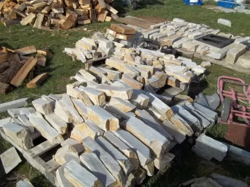

And I've still got some stone left for the other 2 short sides. The back doesn't matter since it will be about 10" from a parallel wall (so invisible) - I can use 'whatever' for the back (like uglies, off-colors, bricks if required, etc..).

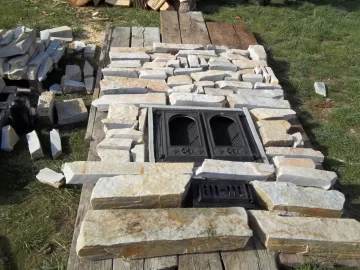

I've got big stones for the bottom. Because they are thick I'll build a bench below the door. Like this,

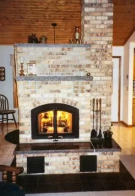

I'm going to try and put the clean-out doors on the sides not the front like in this picture. And I've got some granite scraps so I'll figure out some sort of design above the door. And I was thinking of using white mortar instead of grey.
