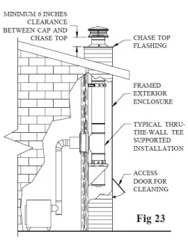

Properly installed, I'd go for the stainless in an insulated chase. My reasons would be warmer stack, easy to clean, proper sizing and tightly joined components. Then there is the coriolis effect so important for good draft. :)
  • [Hearth.com] Masonry vs. Stainless Steel Chimney
A stainless steel class "A" chimney tested to UL HT-103 standard is hard to beat. Steel expands and contracts more readily than masonry, and so is less prone to thermal shock. In an insulated exterior chase you will likely have greater success with this than with masonry/terra-cotta.As others stated, it will heat up PDQ . any problems with "non self-starting" will be reduced as well.
