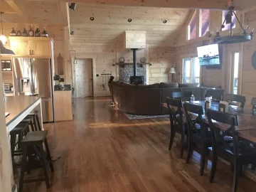

We used concrete for ours. It does hang over a little bit. They poured it as one full slab and then they made contraction cuts. It’s been over 5 years and it has not cracked. We do have a bottom heat shield on our stove. Sorry it is a Christmas pic.
How high is your hearth off the wood floor? And do you like having it at that height? Easy to deal with ash and reloading?

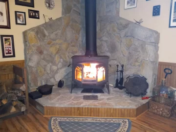

I have a raised hearth and someone once said "you don't put your TV on the floor" so that's my logic behind a raised woodstove. My hearth is about 8" high and covered in stone that I picked up from a local rock slide. It was a cut for a road and when it came loose it broke off in sheets. I picked up a lot of rock, some sheets were 3-4' square.
How do you like that 8" height? Wish you would have gone higher/shorter?
Pretty satisfied with it. My stove is a top loader and it's convenient to load. Has a swing out ash pan so it's easy to clean. Height worked out great as far as a telescopic DW stove pipe to the chimney directly over it. My hearth is in a corner and it's large enough I can stand on it and get around the stove and 8" is an easy step up.

Pretty satisfied with it. My stove is a top loader and it's convenient to load. Has a swing out ash pan so it's easy to clean. Height worked out great as far as a telescopic DW stove pipe to the chimney directly over it. My hearth is in a corner and it's large enough I can stand on it and get around the stove and 8" is an easy step up. View attachment 312524
This looks fairly similar to what we're thinking! How much clearance in front do you have from glass to edge? We're hoping for 22" - 24".
18" in front, we don't burn with the doors open usually. Top load and if I want I can stand on the hearth and load, when raking coals or positioning the first splits on reload it's handy. Learn from our mistakes. Plan the base and lay it out dry, we made a mistake and you can see where it's chipped on the left side, dropped piece of wood. Didn't allow enough overhang, probably going to change the front lower part when we get to redoing that room. Our stove has adjustable legs so it wasn't too much of an issue but if using rock make a template of where the stove feet will sit and make those stones the same height. We worked with rough non-uniform rock.
It is 15 inches from wood floor to top of concrete. We love it. As far as easier to load I really have no reference point because this is our first wood stove. The cuts in the concrete really weren't so much to prevent cracking but more of making it look like 4 smaller slabs instead of one big slab. Having it higher also makes it easier to see from other rooms. I included a pic.
We didn't build it this way for ease of loading. It was more to make it a focal point. Originally we were going to use a premade floor pad but it just didn't feel right just plunking it down on the floor pad.
From glass to edge of hearth, how much of a distance do you have?

Do you find that it's too far of a reach to load, clean, etc. from the floor? Or do you typically have to have one knee or foot on the hearth to reach inside the stove comfortably?
I have no issues with it and I am little. Only 5 ft tall. I set it up through the front but add wood during the burn through the side door.
