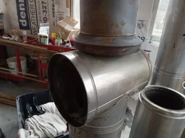

Revisiting this topic, I have need to identify brand of pipe for installation (prob need a few adapters) No identifying markers so far as I can see.
Looks similar to superpro?
Thank you in advance
