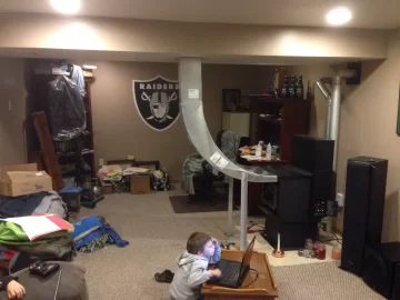

This is what I did and it works perfect. Being a sheetmetal worker I have all metal duct that is properly sealed. The return duct is run directly to the discharge of the stoves blower. A half inch of clearance is at the stove. The door is able to be opened fully and the elbow is quickly removable for deep cleanings. It's not the prettiest thing but it's well made and serves its purpose. I have temps to within 2 degrees throughout the entire house on both floors.

Click on the pic to view it all. I don't know what I did wrong but the entire pic is not showing up in the post.
