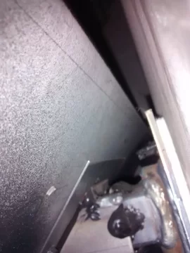

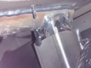

Been fighting a dirty burn/black glass for the last several weeks. Been thru gasket checks, thorough cleaning and everything I could think of or find in the forum. Then I recalled someone mentioning the pellet feed chute. Not sure how things are done at AM/FM in quality control but I may have found the source of unwanted air. Holding a lighter around the uncaulked areas it really sucked the flame in.

Then I'm guessing quality control at ESW is lacking because it looks as though there was never any sealant applied to the area except in the middle of the tube area there was none showing at any of the corners. This was not due to shipping, although heating and cooling of the unit may have caused the leak to intensify.
After contacting ESW about the problem they are sending hi temp silicone and new gaskets for the stove to hopefully cure any "air" problems I may have. Although I am having issues I don't think I should with a new stove I will say customer service is doing what they can to help me solve the problems. :)
Did you use a mirror to look down into that channel?
I don't think you could get an angle to look down it, just not enough room through access covers. One side of the feed tube is near impossible to access with the convection blower in place anyway. I just held a lighter at the areas I could reach and watched the flame being drawn in around it. I put the stove in diagnostic mode and turned on the exhaust blower in order to test it for air leaks. The upper tube, which is part of the hopper, slips into bottom portion when assembled and as I understand it the sealant can "slip" when the two pieces go together and not get a good seal. For whatever reason mine definitely had a bad leak in this area.
