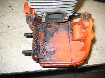

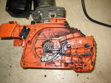

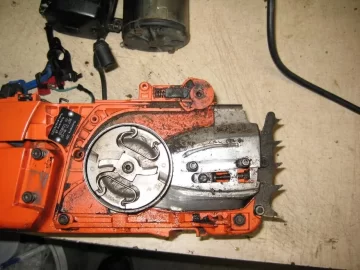

The problem with the 350's is where the brake handle attaches to the case. This is also where the return spring is mounted. Heat from the muffler melts right through the case and into the spring mount. I can post a picture of one I have on the bench later tonight or tomorrow.
^ OK Now I can visualize the problem....thanks Jack. Does the muffler always run that hot or is this the result of a dirty filter...just asking cause I dunno. If it were my saw and there was no factory fix I'd either get another saw or mount some fabricated deflector shield out of flashing. Surprised to hear that Husky would design something like that.
The good and the bad...

fyrwoodguy said:
the pic's explain the muffler bolt fell out?(or loosened up) ....and melted the crankcase.
Nope, unless someone replaced the jug already and who would do that with the case obviously junk? The muffler holes are ok and that cylinder will be going on the good case.
