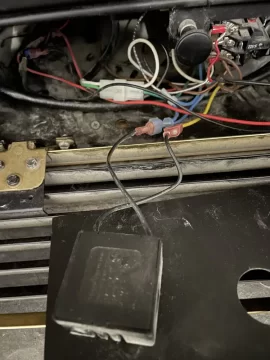

I checked all the connections and vacuumed all the dust and cobwebs out. Everything looked good. Fired it back up, heard the “click” when it gets up to temp, and nothing. Am I to assume the fans are bad? Does anyone have a good place to look for them online? Cheapest I have found is $150 each. Could it be there thermostat switch? I bought a new one and tried this afternoon but maybe I placed the wires on the wrong prong? It’s a magnetic style I bought on amazon. Thanks for continued help!

I believe this is the rheostat, correct? Which wires would I pull and touch to each other? I what is the result I’m looking for?

not sure what to do to check the rheostat with the wires having the caps/ plugs on them. Anything else I need to check, or should I order new blowers? Thanks
The wiring in your pic is different. Is that the reostat? You posted a picture of the back side of it... its really simple a reostat only has 2 wires that go to it. Do what he is saying is disconnect it and jump them, same with the heat switch. By doing this you are isolating the potential problem to just the blower. Then plug it back in. Be careful this is house current and know your limits.
