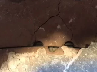

Hi everyone. I found and tried to ship (at an outlandish price, I might add) a Meridian Stove. Despite being crated, on a palette, etc. Fed Ex managed to drop the stove and it split around the firebowl, above the feet. The CFC liner is destroyed (which does not appear to be hard to replace assuming I can find the stuff) and the inner firebox ceramic brick has shifted and is damaged. Despite being told that I am an idiot for trying, I am attempting to repair the stove. If anyone has any expertise in this area, I would greatly appreciate hearing from you. The biggest challenge will be resorting and patching the middle ceramic layer, and remounting the door assembly into that layer. In the end, I would like to have more than a pretty planter, but....
I do have some specific questions, if anyone knows.
1) In the back of the middle layer, there are two small holes, part of the original casting. What are the purpose of these holes and does the ceramic fiber layer completely cover them? (See picture; the holes are out of alignment here.)
[Hearth.com] Meridian Tile Woodstove..Is there anywhere to get one??
2) Does anyone know how the upper and lower layers of both inner and outer ceramic bowl are bonded together? There does not appear to be any type of glue; is there a rebar-like mechanism? It does appear that I will have to lift off the top part and re-align, then patch, the inner bowl.
3) How is the main bowl attached to the feet?
Thanks - it made me cry to look at this.
