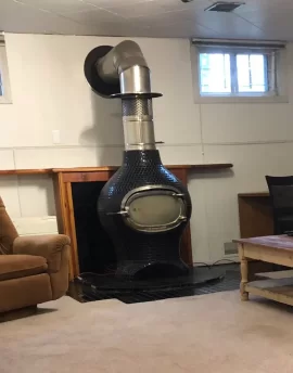

Hi, we just moved into a house in Oakland California and there is an original Meridian Tile Stove in great condition that we may need to sell. We are planning a remodel and it doesn't work well with the new floorplan. Its in great condition and is beautiful, so we're sorry to have to part with it. Shipping seems difficult so we're hoping to find someone in the greater Bay Area that is looking for one. Please reach out if you're interested!
