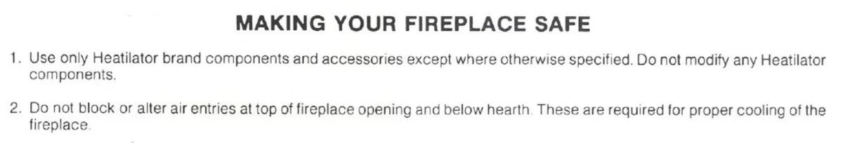

No, they can not be covered.
begreen
Mooderator
Staff member
Nov 18, 2005
99,029
South Puget Sound, WA
Blocking the vents violates the UL certification for the fireplace and may affect the cooling or clearances in other parts of the fireplace besides just the face. Also, there is no telling what the next homeowner will want to do with the fireplace. If they revert it back to woodburning it could be very dangerous. The manual specifically says, Don't Block Off the Vents.

Those vents are also required even if it is only gas logs in there

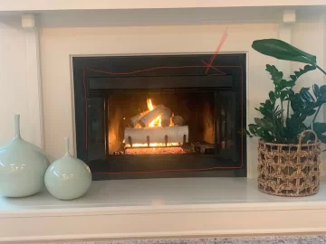

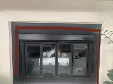

And to be clear I’m talking about putting marble highlighted by the red lines. Not blocking any vents. The diagram in the install guide make it seem like that is okay.
Follow the instructions on page 16 of the manual for facing.
