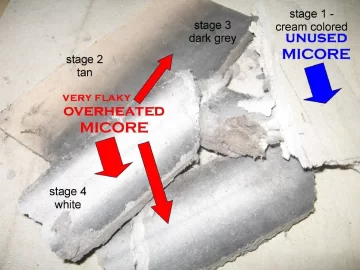

Here is a picture that shows the 4 stages of MICORE. All the overheated pieces are actually sitting on a fresh piece of MICORE and a small piece of fresh MICORE is on the right. When it gets to stage 4, it is so light and flaky ( it actually almost sounds tasty) it just falls apart into dust...
