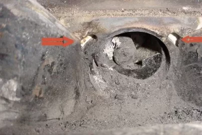

Just curious, and please forgive my dirty burnpot. After shut down this morning and reading your post, I did quick scrape just to see if these are the two holes you speak of. These holes have been mentioned in some previous posts, but never a picture posted with them, and I have always assumed that these are the ones that are being spoke of, are they? Hope there are not two more holes being elusive in the burnpot.

I was wondering the same thing. They don't appear to lead anywhere. I've noticed the same thing on mine, but haven't paid much attention. I thought it was for a resting place for the flame guide.
HarmanP68 said:
other posts say these are airholes...and yes those are the ones...
Well, I ran a thin wire down them to make sure they were not dead-ended and it went a couple of inches into what felt like open space, probably the same chamber that contains the ignitor. Mine have never appeared plugged during any of my cleanings. I guess they are air holes because there are matching recesses on the under side of the plate that goes over burnpot. You would think that if they are important that Harman would at least mention them in their 'Burn Pot Maintenance section of their instructional manual. That is one very poor manual to say the least, but that has been brought up on many other posts. I guess if they give to much info, their consumers will never call the dealers for service. Well, at least we have this forum for useful information (sometimes).
Yes, those are the air ports I spoke of. Thanks for adding your photo.
These two ports lead to the belly of burn pot, verified with a mirror. Mine probably got plugged up from being too aggressive with burn pot scraping, over time. Now that I know what can happen when these get plugged up, I'll go easy with a sharp chisel instead of the tool provided with stove.
Yea, the matching recess in flame guide was the giveaway for me.
Also, these ports seem fairly deep, make sure they're completely free from debris. This procedure will now be included in every cleaning this stove gets. What a difference it makes.
