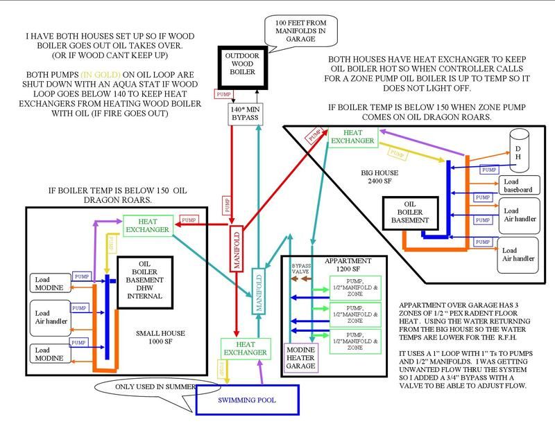

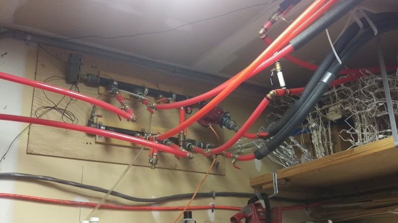

I think I lose more heat than a degree or two before it gets to the heat exchangers via the manifold in the garage and splits off to go to each basement. The boilers hardly ever get hotter than 165. Never seen them over 170.
I bought the insulated pex when I bought the original boiler that failed, I can't remember what kind it was but it was insulated and wrapped in what looked like a plastic 4" flex drain pipe if I remember right. I do remember it cost me a bunch. It is buried 40" deep except for where it comes into the shed and the other end that comes into the garage. The pex is 1" and I put the pipe insulation on it except right at the garage manifold (I will do better there soon) the garage run is then run inside the insulated 2x6 wall and enclosed in the insulated ceiling.
While refilling the wood shed this afternoon I noticed that the new boiler blower comes back on at 174, so it only has a 5* spread. I think that is probably going to work better for me, I notice the boiler is not making as much creosote as before also. Not sure if that has anything to do with it but heck, take good things when you can.
My heating diagram makes sense to me but I once drew out all the air, water, hydraulic and electrical systems of a nuclear submarine onto a spiral notebook while getting qualified in the Navy. If they look like a Martian drew them out to you I'm sorry.
