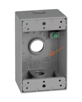

These boxes are design to be mounted using these spastic little lugs that screw into the rear of the box and then to whatever you're attaching it to (just little pieces of metal with two holes in them). I prefer to drill two holes in the rear of the box and put through bolts through there into holes in the side of the shipping container. Seems much more secure. I'm curious peoples' thoughts on this.
I'm pretty sure it's against code to modify a listed item unless the instructions specifically allow it; as far as I can tell, there are no instructions for these boxes. Given this work won't be subject to inspection and is not in a dwelling, I don't think I really care about code. I DO care if there's some logical reason for not doing this. I know if you have metal going from the inside to the outside of a box, it can potentially expose hazardous voltages on the outside. But with metal boxes, which of course are grounded, this shouldn't be an issue, unless the metal fastener is somehow not in contact with the metal box and gets energized by an un-grounded conductor. I suppose this is possible, however the shell of the shipping container is of course well grounded also (tied to EGC and to a dedicated metal ground rod). So the through bolt would have to accidentally contact an ungrounded conductor AND somehow contact neither the box or the shipping container wall. I could always put RTV silicon on the inside part of the bolt and nut. And I believe it IS allowed to put screws and nails through ordinary metal boxes (handi-boxes and such).
The other issue is it could allow moisture inside the box, but of course I'll silicon the bejeesus out of the holes and around the perimeter of the box.
I'm probably overthinking this. I'm just gonna drill the damn holes.
I just installed one of those, and the brand I used (Sigma) had designated spots for through-hole mounting.
Also, you can probably add an o-ring to the male PVC adapter going into the back of the box to seal it.

Drill a small weep hole on the bottom for anything that gets in.

You can drill the holes and mount it, but that may void certain waterproof-ness listings of the box. Whether you care should depend on how wet the location is and how likely it is to get waterlogged.

Are those supposed to be floating, and held in place from conduit? That does not seem right either. I myself would mount it whatever way and drill a hole in the bottom smaller than a spider.

No, I punched out the holes in the back of the box, thru-bolted it to the wall of the shipping container, and put silicon RTV everywhere. I',m just gonna omit the little plug that seals the threaded hole in the bottom of the box.

No they come with little tabs that attach to the outside of the box and you're supposed to secure the tabs so there's no screws penetrating the box itself. Sometimes that works, other times not due to the placement of the tabs.

I think earlier in the thread (post #3) we established that there are in fact two places in the rear of the box that are easily punched out so screws or bolts can attach thru those. I did it that way, and they are clearly meant for that - it just required a gentle tap on a center-punch.

Right, and those are fine to use when you don't need the specific level of waterproof-ness that the tabs provide.

I know I have used some "plastic" boxes that had mounting tabs on two corners, but I don't know about those cast metal boxes. If a guy were to use EMT ect you probably would not to mount it anyway as you could bolt/screw down the conduit which would hold it in place. I can't remember the last time I used the metal ones. It make since to punch out the holes to be unless it's a spray down marina or car wash ect.
