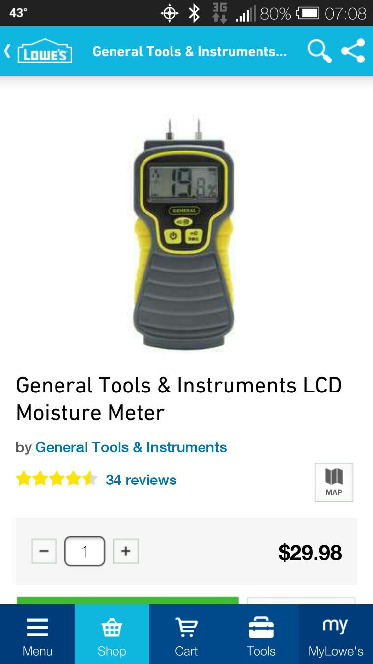

I got this one from Lowe's. Seems to work good. It think it was on sale for $25 when I got it.

+1 on the General. Seems to work fine. $29 when I bought.
Another vote for the General from Lowes. I use it and it seems accurate enough for firewood purposes.
