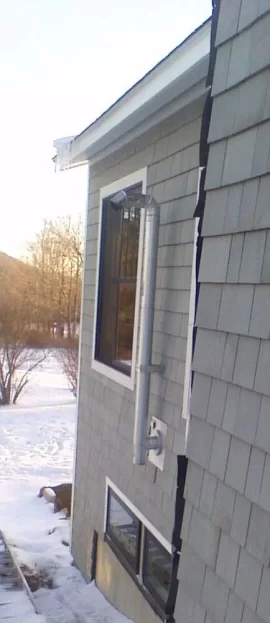

Post picks of install
Tell others about your home size age and layout, windows, insulation ...
It's all useful to those helping you

[Hearth.com] Monia Piazzetta help Home size 1800 square feet. Stove is in new addition unheated room one story 15 x 20 with argon filled insulated low-e windows. Room facing south-west. Really well insulated.

The install pic looks fine. Can we see a pic of the stove's flame when running? Can we see a pic of these "unburned pellets"?What pellet brand are you burning? When did you have the stove installed, and how many bags have you burned so far?

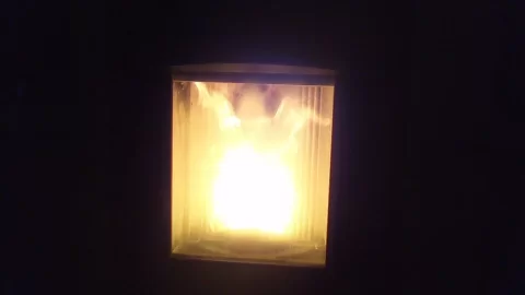

4) The stove did not always have unburned pellets. Maybe once last season. I don't have a photo tonight of unburned pellets. Here is a photo of flame at P2.

Another question is how does the grate look when you clean it, are the holes all plugged? Does the fire box have white ash coating the walls or blackish ash? Is the flame whitish or yellowish to your eye, and is it more yellow this year than last? Any black whisps at the tips of the flame?
And, does the pic accurately reflect what you see? If not, can you try exposing the image on the center of the flame, that will darken the exposure and allow us to see a little more detail.
Do you have much black carbon buildup in the burn pot? Some hardwood pellets cause this I think, more so than softwood pellets.

4 ton since I bought it.1 1/2 so far this year. Yes, the holes are kind of plugged... thick ash like clumps that suck up into the vacuum as a whole. White ash days..but every once in awhile it goes black. Flame is completely yellow. No white at all. Looking at it right now I do not see any black whips at tips. I turned the stove on at 5:00 pm. It is now 8:00 pm. The glass has white ash on it so I would not get a good photo of the flame. Will have to wait.

White ash dusting the walls is good, black is bad, whitish flame good, yellow verging upon orange bad. Black whisps bad.
As 709 notes, keep the holes in the grate open when you clean, that's how the air gets in, and if the air is restricted the combustion will worsen. Clumpy ash, if it's hard like volcanic rock, might be clinkers. That's due to the minerals in the pellets that siliconize or whatever the call it under high heat. Not much you can do about them.
From what we seem to know now, I would first clean thoroughly, using a linteater, and a leaf blower. That should bring your stove's cleanliness back to its original condition. Only when the stove is super clean can you work on fixing the combustion to get a clean burn.
