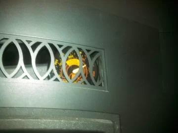

I was lazy today and didn't remove any ash from the insert. I feel that it is burning hotter and staying there longer than it usually does. Could this because of the extra ash? I usually clean some out every day so that I can fit more wood in there. This seems to be working better though. Maybe the 36 inches of show that we got last night are going to my head.....

I think most stoves run best with a good ash bed - I only clean mine when it gets up to the lip. Or, it may be all that snow insulating you home??

An inch or two of ash is usually recommended by the manufacturers. Too much ash creates unburnt coals that get buried under the ash, and take up room that could be used for more wood load.
The snow is definitely helping, its about 80 in here and I usually have trouble hitting 70. Would the snow insulating the house Hall the stove itself run hotter?
I always keep a thin bed of ash, just enough to fill in the cracks in the bricks...acts like a blanket of insulation.
The snow "insulating the house" is helping reduce heat loss, thus keeping the house warmer.

I clean out ash as needed, but try to leave some.
I agree with Hog. Also, with the VC stoves, too much ash seems to prohibit good air flow.
Yep. I noticed that last year after several snow dumps here. Snow insulates and keeps the heat in the house from radiating out as fast.

I clean out every few days leaving as little ash as possible. While having ash helps keep coals going overnight, it limits firebox capacity as BrowningBar pointed out. More of an issue when you are 2 cubic foot as opposed to the bigger 3+ cubic foot stoves some are burning. I'm not sure that the ash helps reach higher stove tops. For me, it helps the fire burn a little longer as it slows combustion some on the coals down in the ash.
A good bed of ash definitely works better in my stove, I do have plenty of room for wood with an 8 cu ft box ;lol
I found that running my OWB with a layer of ash helped with the heat and the fire. Same with my older Earth Stove. That has a large firebox though, as does the Englander. I always leave a layer of ash in the stove myself.

We typically cleans ashes when it gets up level to the door. Leave a few inches in though. Only time we clean all the ashes is during the summer cleaning.

i sometimes feel like my stove runs better with ash in it than without ash, BUT no ash generally means a cool stove. On those occasions when i remove all the ash before the stove is cool, I don't see as much difference between ash and no ash. I guess ash doesn't really make much difference with my stove. My stove is small and doesn't hold much ash without the ash having a large impact on the amount of wood that fits inside, so I remove ash every two or three days, and when I remove ash I typically remove it all.

On our regularly scheduled topic...I think 1/2-3/4" ash make my fires burn better.
