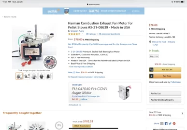

Not a bad price.

Found this on amazon looks to be oem check serial no.
Well, that's affordable enough (which is important to me). Over the past two days, I've eyeballed the back of the stove a bunch of times, trying to convince myself that I should be able to get more involved back there. On the combustion fan, really unsure (A) how to access all three of the mounting bolts when only one of the three looks easy to get at (and this from a guy with some experience restoring a British car, with lots of tight spots) and, worse, getting the fan free of the wiring harness... maybe cut-n-splice the wires :eek: ? I have not looked on-line for a tutorial. Perhaps there is a specified torque setting for the three bolts.

Not sure about the fan serial but if you look at the photo of the fan I sent earlier that matches the serial you have. The motor in the picture is a oem part made by Gleason Avery that’s the motor you want. Your manual should have a parts list in the back with all serial #s listed for your stove. Always double check.
