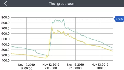

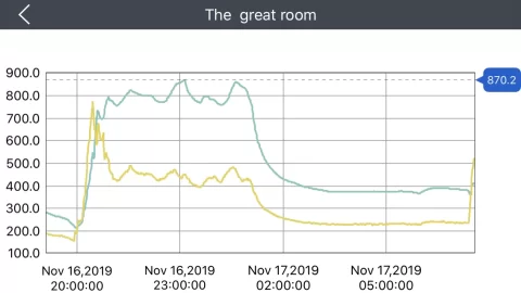

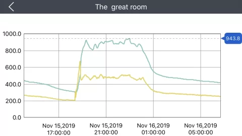

The top blue line is inside stove temp the bottom line is the flue temp 18 inches up.
First is the air 1/2 opened no blower.

second air completely closed no blower.
there a big difference in the spread between the inside stove temp and flue when air is 1/2 open and closed. Stove seams to also run hotter with it closed.
tonight I’m running completely closed blower on. Let’s see the results tomorrow.
