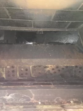

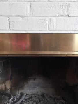

Alright, reporting back. Here are the pictures of the fireplace seen from the firebox floor and up.

Also, related to the "smoke blocker", it is 3 inch so the smoke pile sup and still "underflow" from it.
This is the "smoke guard".. it is 3 inch wide (going up and down) and i measured it from the inside of the firebox.

This is the view of the firebox ceiling as if you were looking from the center/back of the firebox floor (see how is a straight shot up the chimney). I had the damper open so you can see the light of the day (there is a rain cap there too):
[Hearth.com] More newbie questions
And this is the same as above, but as if you were sitting and looking up from the center/front of the firebox floor. Take notice of that rubble that was put there to close the gap between the firebox structure and the brick that i think is the front view below my mantle (they also are seen in the picture above).

your damper it to far to the back there is a flat shelf infront of it and your smoke chamber does not look like a smooth transition. All in all it is just bad fireplace design. Not a whole lot to be done with it. You could try to put in an angle piece of metal from the lintel to the front of the damper frame it may help. And you could try to smooth out the smoke chamber but again it may not help that much.
