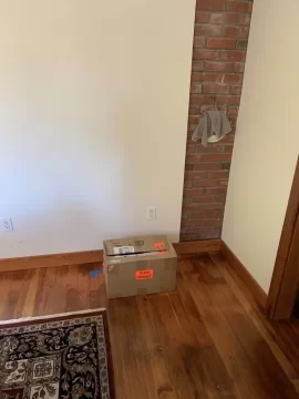

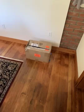

I’ve considered the F45 but I’m limited with space in that corner and even with clearances reduced stove protrudes. I like the looks of the f500 Oslo but it’s prob too much stove for my home and I’m not crazy about the new fyre tech. When I say I’ll add noncombustible behind I’m saying clearance affected surfaces will be metal stud-concrete board- tile. Properly done it seems like the manual allows u to reduce those clearances. Says even with non combustible surfaces clearance must be no less then 4inches. The stove will be used as a supplemental source of heat mostly thru the colder days of winter.I’ve heated the entire house with cadet space heaters for the past few years. I know the 3112 fits a 12” split but I thought the 3142 would fit a “15.
Even with an NFPA 211, ventilated wall shield the minimum clearance allowed is 12" unless the stove mfg has tested the stove and included the tested lower clearances in the documentation. The F45 has a reduced clearance table.

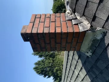

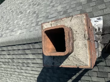

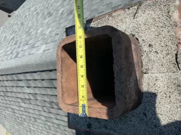

The clay liner is 7.5”x7.5” attached photos. What’s my best option to run the 602 considering everything? On a side note, that chimney is aprox 28” from the peak of the roof, does anyone know the min height for that? I’ve scheduled for someone to rework the exterior including new crown prior to a new stove install so Ill need to verify that chimney out of roof req. for Wa state.
View attachment 281548 View attachment 281549 View attachment 281550
It needs to be 2' above anything within 10' so you are good there. And you will need to remove those liners in order to bring the chimney up to code. It also looks like it needs some flashing work
So it looks like it’s only around 6 -7/8” at most was being a bit optimistic haha, but looks like taking out the clay will clear up a lot of space. After having the clay removed will it accommodate a 6” insulated pipe? I’m just assuming the pipe internally is 6” and then how much space will the min insulatation take up? Also flashing repoint tuck and crown are all scheduled but will hold off on crown to take the liner out if need be. And with the insulated liner inside the >3.5” masonry chimney after removing clay, my existing framing is against the brick in many places up and through roof, and so what I’m trying to understand, thats okay using the insulated liner?
Yes a 6" insulated liner will easily fit without the clay. A wrapped liner will be 7.25 to 7.5.
