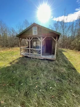

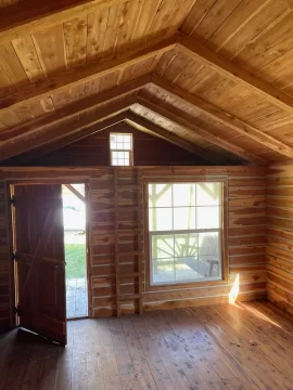

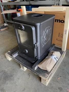

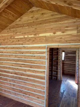

Hello, new here. Stumbled on the site as I was considering a wood stove for a small cabin. I think I am leaving this little cabin off grid, but I plan to furnish for comfortable weekend stays. I had envisioned a classic cast iron stove with a rustic appearance. Since it is a cabin, I also plan to occasionally cook on the top of the stove. So after some research, I thought I wanted a Jotul 602, but there are none available around my area. The closet Jotul dealer said it would likely take nine months to get one. I then stumbled on a local dealer who had one Morso Squirrel 1410. It was ordered extra and had just came in. I hurried down to look at it, and was a bit surprised at the size. It was pretty small, but it really looked well built and I loved the classic look. Perfect for the small cabin which is ~520sf. I was also surprised at the price! These little guys are not cheap. Since availability was limited, I went ahead and bought the unit. Now I am planning the install. I have a clean slate, wide open room and considering the optimal location. My question for the forum is, has anyone installed the Squirrel 1410 with the flue exiting the rear instead of the top? I would think optimum draft would occur with a top mount flue, but I could use the surface space on top with the rear mount. I do like the look of the top mount flue, but it there are no considerable drawbacks to the rear discharge, I will likely go that route. I could also install a clean out T on the rear too. Anyway here are a few pics and would appreciate input. Thank you.

Nice cabin and stove! There will be no drawbacks by going the rear exit route...your only concern will be getting the 15 ft minimum stack height..
Beautiful cabin. Is that cedar?
Awesome looking little stove as well.....All cast iron?

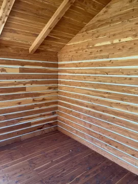

Snobuilder, yes, it is made of 100% cedar logs. Even the doors and floor are cedar. The stove is cast iron, which is one reason I liked it.
Yea, we will see how it burns. Going to install a stone or tile area to set the stove, then begin work on the flue.

Thats my thoughts as well. Put the pipe inside, go up through the metal roof. Although I hate punching a whole in the roof, I hate the thought of cutting a huge whole in the logs to exit the side. I will likely go through the roof.
Initially I thought single wall pipe for more heat radiation, but I agree that the double wall pipe may be best. I can place the unit in the corner, but that leaves me with the shortest inside pipe run. Or I can place it more center on the wall, which has the highest inside ceiling height to give me a longer inside run of pipe. The corner may look best, but centering it may be best overall position for pipe run and heat distribution. Thank you for the input!

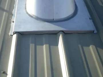

They make a special flashing for a metal roof. Done right, it will provide good protection.

Definitely don't use a rubber boot. Get a metal roof flashing from Excel or Ventis (Olympia/Champion).

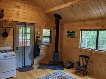

We have a similar sized cabin and installed a Jotul 602 in it. I used Duratech chimney and their double wall telescoping stove pipe. They sell small sections of insulated chimney painted black so if you use a roof chimney bracket, and extend the chimney into the room through a ceiling flashing, it looks good inside with the stovepipe. One thing I would do differently if I could have, is use a roof flashing like begreen pictured above. It looks much better than the Duratech version of the same. I'm not sure I like the vented crimps on the Duratech one as it lets snow blow under the storm cap, but that's a minor issue. It just doesn't look great up there, like an afterthought.
Here's a pic of our setup. I followed Jotul's clearances and installed it in a corner. Jotul also had a minimum chimney spec height that I'm lower than (the clearances and height are fine with the peak, etc). I'm sure the double wall stovepipe helps with the draft, anyhow, and I figure I could always add a section later if necessary. It hasn't been, and works great. Good luck on yours.

sesmith, thanks for the info and pic. Looks great! I was looking for the little Jotel 602 but couldn't find one around here. The Morso is similar. What size pipe is that? 6" or 8"? Maybe it appears larger due to the insulation and telescoping feature. So how does the Jotel perform? Does it heat your cabin adequately? Thanks again for sharing!
