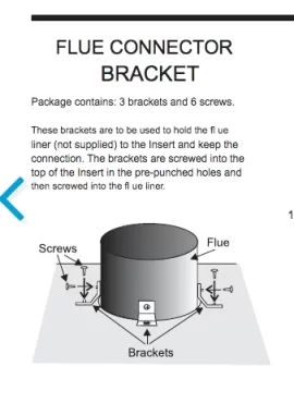

I just ordered the Auber AT200 thermometer with the washer probe and I was curious where you guys recommend mounting the washer probe on my steel liner? The liner is attached to a Regency i2400 insert and was thinking of possibly mounting the probe via one of the flue mounting bracket screws (picture attached). Or would it be preferred the zip a new screw in somewhere else in the appliance adapter that is attached to the steel liner? Thanks

You can tuck it under the band clamp on the appliance adapter before tightening.
