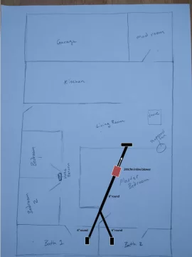

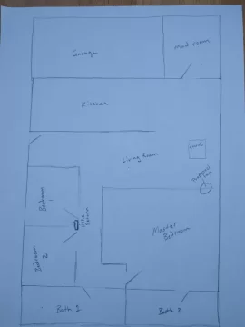

Please forgive my crude floorplan. Obviously this is not to scale but it should give an idea.

I installed a Broan 510 in the wall of the master bedroom that exhausts into the living room and an intake louver in the bottom of the closet door to the walk in closet where the fan is installed. The fan is high on the wall , but the intake is low (cold air first) and with the closet door shut not much noise.
It works well and raises the temp of the bedroom three degrees as well as reducing the temp of the stove room.
That plan is similar to what jbeau has drawn. I like the idea of mounting the fan high, with the intake low, using the wall cavity. Tjerlund also makes a fan system for this. I'd opt for the quietest, which may be the Broan.
