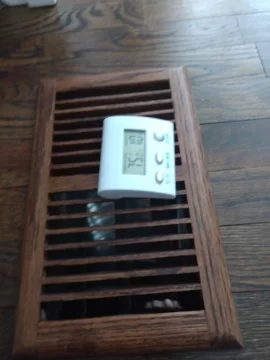

Yes, I have seen 95 F air coming out (thermometer laying on the register that I put in). I just let the stove go out, so this is natural convection 75 F now.
My duct is only 2 ft long. But I plan on making it longer to 15 ft or so, out the fan at that far end, and reverse directions. Now hot air comes out here, sucked from near the ceiling of the basement.
Then I will suck cold air from the floor, and blow it on to the floor of the basement where the stove is, pushing warm air up the stairs into the main floor.
People here say it works better to move cold air. And I hope to then have more noise in the basement and less on the main floor with the fan farther away and blowing away from the main floor.
