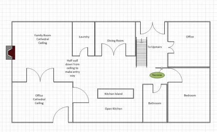

I was looking for some advice on how to get the air flow moving to move the hot air from the family room to the other end of the house. I am attaching my floor plan which is not to scale. The family room is cathedral ceiling but has 2 ceiling fans in it that are running on the reverse setting. I also currently have a box fan on low (smallest fan I currently have) near the left side of the kitchen island on the floor blowing air into the family room where the fireplace is. Unfortunately, I can get the family room to 74-76 degrees, but the end of the hall where the thermostat is is at 65-66. Any suggestion? I am also attaching a picture that shows the half wall in the family room into the kitchen so you see what I mean. Thanks in advance for any suggestions.

Cathedral ceilings can be heat traps. As a test, try running only one ceiling fan in reverse and the other one blowing down. That may mix the room air better.

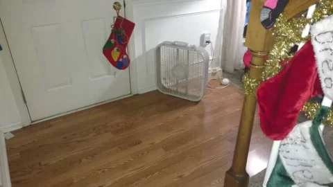

What about putting your fan by the bedroom? Have you tried that?
Sent from my XT1585 using Tapatalk
I have not tried that yet. I will do that now. I wasn't sure since it wasn't a direct path if it would make a difference. It is close, but there is some furniture partially blocking the direct path.

We have a center hall colonial which is a horrible layout for a fireplace, IMHO. I have this box fan by the living room, pointed towards the dining room. The fireplace is in the family room, which is opposite wall of the living room. That fan really does help move the colder air throughout the first floor.
So don't discount the power of the fan, even with objects in the way.

I use a small fan on the floor of a doorway to the next area of the house from our stove. It blows the cooler air at floor level toward the stove and as a result warmer air flows into the next room. The fan is on low and the temp in the next room goes up ten degree pretty quickly.

No we can't do another stove. We do have a blower. And I keep it on low. I have 2 fans running now that seems to be working. Although I was also baking today too. So not sure if that contributed to the warmer temps or not in the house. I have a fan at the left edge of the kitchen island and then another fan by the bedroom. Both blowing in the direction of the room with the insert.

I would assume that you would want to have the fan closest to the fireplace in reverse since the heat naturally rises there. This will help push the heat across the ceiling. Put the fan near the opening on regular to help push the heat to the opening.

We have made some progress. I have the ceiling fans still in reverse. But I moved one fan to the doorway of the spare bedroom and one to the edge of the kitchen blowing into the family room. I was able to get the kitchen to 69 degrees and the bedroom up to 66 degrees which is better than the 62 it was at after about an hour. I only have 2 box size fans and both are on low. I assume this would work with smaller fans but unfortunately this is the only size I have. Thanks for the advice because I didn't think I would get any heat in that back bedroom and this will work.
