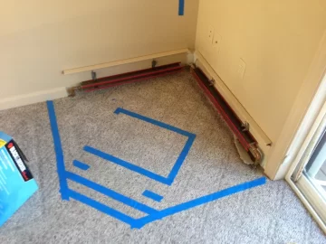

Had a superbowl party last night. My friend who will be installing the pad for our XXV was there evaluating the proposed location of installation.
We were planning on having him eventually install a hearth. There is a baseboard heating element that is in the way. I know I would have to call someone to do the job. Does anyone have any idea what it would cost to move the 10ft baseboard to another wall?
My friend installed a hearth for my brother and we really like the look of stonework on the wall. But we are not sure if it will be worth the cost of moving the baseboard.
He said he could build around it, but that it wouldn't look very good.
Any advice would be greatly appreciated.

Take a picture of the area you are looking to install the hearth. Do you have a basement, crawl space ? would help to have more info on the area you are trying to remove.
Sorry for the lack of info.
We have hot water baseboard. There is a drop ceiling installed in the basement below the area of concern. The tiles fit very tightly, and removing and replacing them to access the piping would be an issue. I installed a theater in that room and broke several tiles just trying to get them out.
I am considering removing the piping cover and having the hearth built around the exposed piping. Then cut the cover to fit flush with the stonework.
If I were to have it moved, the length would need to be halved since the only other available wall has even less available space.
Does the pipe have the air vents built on ? You should remove the section of pipe and replace with a solid pipe. Also sleeve a larger pipe around the cooper pipe incase you have a problem you can remove the pipe without disturbing the hearth.You would hate to have a problem with the pipe after you buried it with the hearth
Only the front of the cover comes off. The top is a fixed part. I have no problem cutting the top of it off.
That is a good point. I can't imagine having to deal with an issue for something buried behind a few inches of stone.
you can use a grinder to cut the top and back but it makes a mess and smells bad
Thanks Mike! That is extremely helpful. I can just build a riser for my buddy to lay the stone for the pad on. And then build the back of the hearth above it. That will leave me space to manipulate the pipe without disturbing anything, should I ever need to.
Taking all the tin panels off isnt to bad. After pulling a few nails out of the tin that hit the studs its not to bad. They lift right up. I could have got real creative and put louver or grates in so the baseboard heat would still work but I passed on the idea.
