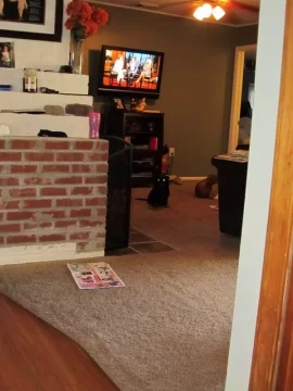

Pic 1: trying to displace hot air into master bedroom. Is this how you do it?

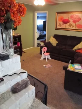

Pic 2: shows angle from stove.

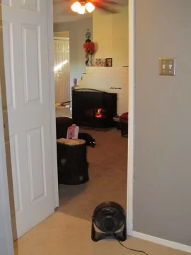

Pic 3: I'm also trying to move hot air to the other side of house (down hallway to bedrooms) as well. Will this counteract my intentions on the other side?

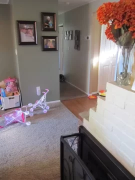

Pic 4: shows angle from hallway.
Should I blow floor fans into stove room from both sides? If not, what do you recommend?

Turn your fan around and blow the cold air into the stove room. Works like a charm for me.
Stax said:
I think the dark fan made that less noticeable. You should be fine.
Looks like you have the right idea. I don't know if it helps or not but I don't turn the fan up just keep it on low. I also keep it pointed towards the floor.
Do you have a forced air furnace..if you do try just running the blower to equalize the house temps.
But your idea should help blowing into the room with the stove,
We find our ceiling fan will help a lot..though we hardly use it or the blowers on the stove..I hate hearing fans.
Right now, I'm in the experimental stage. With both floor fans on low blowing into stove room, it cretes a cold stream near your feet. Didn't like that so much. Turned off the hallway floor fan, left the bedroom one on. Seemed to work pretty well, however it took 5+ hrs to bring bedroom temp up 4 degrees. Seems like heat wants to naturally go the other direction, down the hallway (where thermostat is located).

Stax, make sure the fans are run on low speed. The one in the hallway would be better served right as the hallway meets the room.
Pictures don't show enough. You may need another fan further from the fire, as well as the one at the edge of the fireroom.
How hot are you running the fire? Starting from a cold house?
The current setup is interesting. I'm running the fire anywhere between 350-550. Blower, on low to medium. It's too loud on high. I have two ceiling fans on low in the stove room (winter mode). Right now, I can only take one more fan running, and that's the one coming from the master bedroom into the stove room. If I turned the hallway fan on, that would give me 4 fans running plus the stove blower. Too much for a 275 sq. ft. stove room!
And yes, starting from either minimal coals or a cold house.

Tape some strips of TP at the top of the doorways, so you can see the air moving. I've found that just moving the fan a foot, or less, can make a lot of difference. I also have them pointed slightly toward the floor.
The TP is a good idea!
My ceiling fan in the stove room makes things worse. My theory is, it is mixing the cold and hot air too much, so the air exiting the stove room is cooler. I do have a fan on the floor blowing up in a non stove room to pull the heat off the ceiling (no cieling fan in that room) and it helps a lot.
Seems like the fan on the floor in the doorway method is a tripping hazard.OK temp but you need a solution thst dont require partially blocking a door way.
