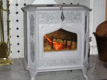

I RECIVED MY NEW SOAP STONE STOVE IT IS OVER 500 LB. I NEED TO GET IT IN THE HOUSE, AND UP ON THE HEARTH IAM BUILDING. IT IS ABOUT 6IN HIGH. HELP!!!

If it's still in the crate rent an appliance dolly and build a ramp up your hearth then dismantle the crate and you should be able to slide it around into place. Also put some rags or cardboard under the legs when sliding in place to avoid scratching the hearth.
If it's already out of the crate you can use some 2x4's under the top lip as handles and have 2 or 4 people lift it up onto the hearth.

Are the firebricks inside? If so, you can remove them and reduce some of that weight. I moved a Napolean 1150p with a regular dolly and the help of one friend - it's around 400 without the firebrick. Be careful and wear steel-toed boots!
Two HD nylon load straps adjusted for the right height can be slipped underneath the bottom and two 2x4s slid into the top loops. Mark exactly where you want the feet to sit on the hearth. Then, with two guys (hopefully near the same height, just step inside between the 2x4s, rest them on your shoulders and strand up. All legs, no back. The stove should be just inches above the ground. If not, put her down and readjust the strap lengths. Now you can position and re-position it on the hearth to a high degree of accuracy without destroying your backs or scratching the hearth. I don't know about carrying it very far that way, depends on how fit you both are. Take a few steps and rest if you have to. If you have four guys, you can walk to town with it this way. If stairs are attempted this way, you'll need to put a slight notch in the 2x4s to keep the straps from sliding. Go slow and take one stair at a time.

If it is out of its crate, you can still use an appliance dolly. Just use 2-3 ratchet straps around the stove and dolly and you can use it fairly easily.

I unloaded our Fireview off the trailer by myself and put it right on the dolly. Then put two 2 x10 planks to get it up onto the porch and into the house. We did not uncrate until we had it right by the hearth. Then I removed the top lid (it just lifts off and is very heavy). We also removed the firebox door and the firebrick. Then we used used either 2 x 4 or 4 x 4 (don't remember right now) under the stove and a couple gorillas (neighbors) lifted it up onto the hearth. Our hearth is 16" high. Then it is a simple matter of putting the lid and door back on plus the firebrick.
