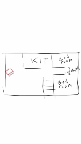

I have a bi-level with about 1000sq ft on each floor. My stove is on one far end of the house centred depth wise on that side , and the fan was placed on the opposite side of the house at the end of the hall. I'll try to attach a rough pic.

How low is the fan and how far away from the stove room should it be?
A desktop fan rather than a pedestal fan works best so the fan sits right on the floor. As to how far away, that depends upon your situation.
Tahoostas, I'd suggest you also try moving the fan. Try it in a couple of spots. In our house if we use the fan, we set the fan at the start of the hallway. There are 3 rooms behind the fan and they all heat up nicely. We tried moving it way back but it just seemed to work best right at the start of the hallway.

do you mean the entrance to the hallway, from the room where the stove is?
Try it at the far end of the hallway furthest away from the stove as long as this provides a direct shot to the stove room. Put the fan, pointing toward the stove room, on the floor and run it on low speed.
i'm confused. my hallway is about 12-14 feet long with a straight shot to LR. are u saying a or b?
a. 3 bedrooms---FAN-->hall ----------->hall door way >-----stoves1--stove 2
b. 3 bedrooms---hall ------------>hall door way >FAN-->----stove 1--stove 2
Could try both. I tried what I think is your option a. The fan being furthest away from the stove and living room. I'm going to try both at my place but will prob stick with option a as that's where the fan will make most sense (not tripping over it).
i'll try a, but i'm not hopeful. the end of my hall is at the opening of two BR's. then at the other end, a few feet before the door way is another BR and a bath/laundry area. i would like this to work, as it leaves the doorway unblocked.
