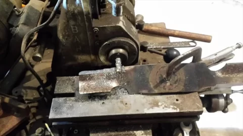

I still do them at home but am probably - errrr - well maybe a little more meticulous than most. These blades were truly abused. This is how I get them back into shape:
[Hearth.com] Mower Blade Sharpening
