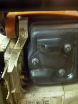

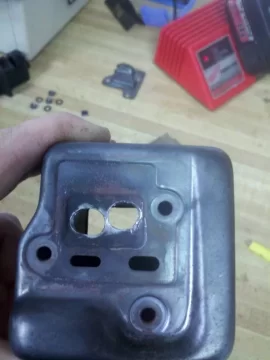

I just did a muffler mod on my 290 and have been pleased with the results. Here are some before and after pics. I left the screen in on mine. I did mod the screen cover a little also. And I used a long drywall screen to get the limiters out of the carb.
  • [Hearth.com] ms 290 exhaust

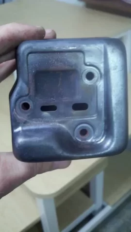

Here is the original 1127 saw muffler with porting, with about two times the open area:

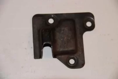

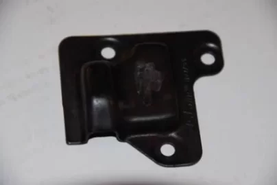

The screen cover mod there is exactly what I do. Here is the original screen cover:
Here is my modified screen cover, ground open:
