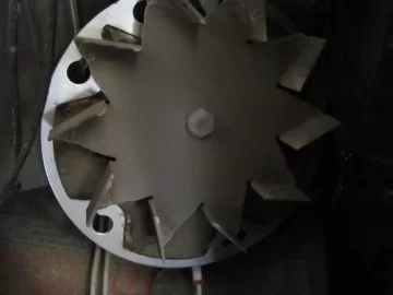

I was expecting the chimney sweep this morning, so I thought that it would be a good time to clean my combustion blower. Quadrafire suggests cleaning it every 3 tons of pellets and I've burned about 3 1/2 tons. So I pulled the combustion blower and I was surprised at how clean it was.
[Hearth.com] Mt Vernon AE Insert -- need more heat.
I brushed the thin coat of ash off the impeller, but I didn't feel as though I was accomplishing anything. I reached into the passage from the fire chamber to the blower and it was in similar condition and finally I checked the blower output port which was absolutely spotless.
I have burned junk pellets (inferno's) and better pellets (Lignetics, Greene Team's). I am guessing that burning hot has kept this stove (insert) clean.
