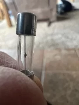

Sorry for slow reply - vacation in the warm made me forget about my stove. Both fuses appear good on main board. As you will see in the pic, my power supply is burnt and I cannot tell if this fuse is burnt or not - all the other fuses do not have that bulge in the middle? Next step order new power supply cord (white) and replace fuse? Or we got bigger problems? Thank you!
[Hearth.com] Mt Vernon AE Missed Ignition Advice [Hearth.com] Mt Vernon AE Missed Ignition Advice
You can do a continuity test on the fuse to see if it is good. And you definately need a new power supply cord. It is a process of finding where the power stops. kap

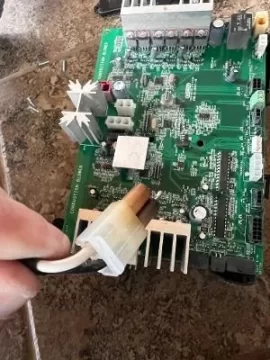

Yes, they make a wire harness with inline fuses, so you don't have to undo control board, to get at a fuse. Before you buy a control board, i would double check power as to where it ends. And you never showed a pic of the control board so we could see if it was burnt. And make sure when you put igniter back, you hung the wires up in the slot, to keep em out of the way of the auto clean. kap
Thanks for all the help. It only appears burnt where the powers went in. It still auto cleans, blower comes on, etc. only missing the igniter as far as I can tell. Thanks
You have to remember, that plug is for igniter only. It is 120v. The other power supply harness runs rest of stove, which is 12v. kap
