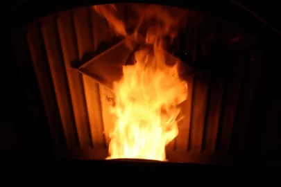

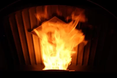

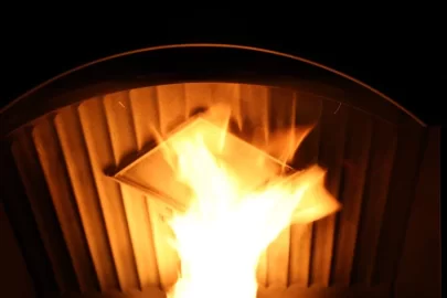

The problem very could well be that my ocd is in high gear the past few days. Thing that bugs me is the amount of soot that has been building up, to me, is a sure sign that I have somewhat incomplete combustion. I just put it back on manual/high and took these pictures. Flame does not seem to be as high as it was a few minutes ago. If I leave the stove on auto & by chance it ends up on high is this not going to overheat the stove? We have 4 birds in our place, would hate to go to town & have the stove overheat & turn off while we are gone.....don't think our feathered friends would appreciate the house with out heat.....:eek:

As for the soot, the pictures posted look completely normal. After a cleaning, my glass will turn slightly hazy within 24 hours, start graying between 24-48 and then start turning a dark gray from that period out. Running the stove on low will accelerate this.
