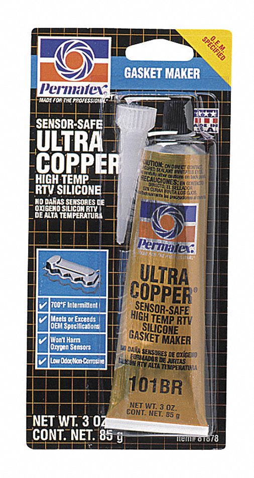

Recently when doing a thorough cleaning of my MVAE insert, I managed to tear the vent flange gasket. There is no reason why I can't replace it with another fiberglass reinforced silicone rubber gasket.
I think it might be easier to put together and seal with a high temperature RTV silicone, like Permatex Ultra Copper.
Can anybody see a reason not to use this instead of the silicone rubber sheet material?
Once thing that comes to mind is that the fiberglass reinforced silicone rubber gasket may be a bit thicker/stronger thus maintaining a better seal under vibration and or expansion/contraction cycles.
