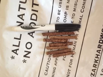

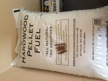

Ok, so since my last post about not being able to get pellets to feed and hearing a raspy noise coming from the auger, I pulled the auger out and vacuumed out the excess pellet dust and cleaned out all the jammed up pellets which I believe was caused by crappy pellets that I bought a ton of like an idiot from tractor supply. These are Ozark Wood products. They are very inconsistent with size! Some are nearly 5 inches long! Its ridiculous really. I'm going to contact them about this issue. Anyway, after cleaning it all out, it ran pretty good for about a day then shut off because pellets wouldn't feed. I was able to stick a wire up the pellet chute and a bunch of pellets fell into the fire pot. So the big ass pellets were getting bridged around the chute. That lasted about 8 hours then it shut off again. When I went down to check, the fire pot was full to the top with pellets and up into the chute overfilling the pot! I was shocked as I've never seen that before. I cleaned the pellets out and scraped the fire pot to make sure nothing was blocking the air holes or ignitor slit. Started it back up, ran for 12hours then shut down with the same overfill issue. I'm so done with this pellet stove! Very inconsistent. So I again cleared the mess up and started it back up. Pellets fell into the pot and a fire started like normal, but a lot of pellets were falling now so I adjusted the hopper slide adjuster nearly closed and that stopped that issue, but about a half hour later, the stove just shut off, no slowly shut down, just shut off with a normal looking fire going! Never had this issue before. After I let it cool down about 40 minutes or so, I opened it up and checked the fire pot, but there was nearly nothing in it, and everything looked normal. Plugged it back in and now no response at all! No nothing. Owner manual says to check the fuse. Is there only one fuse which is located in the control box? Small glass fuse? Or is there another one somewhere that may have blown and why? Snap disc 3 looks the same as it always does, so I don't know how I could try to reset it. I checked the mail panel in the house, nothing tripped. Of course its gonna be 20-30 below 0 tonight and tomorrow with wind chill here in NJ. Please help! Dynamite is my next step

I have about 15 bags left! The first 20 bags burned fine, then the noise started happening in the auger. I'll try to add pics of the moister pellets which some are half the size of a sharpie!

I totally agree with Kap that a bunch of your problems are coming from the pellets you are trying to burn. Sound like just plain junk and they by themselves will cause problems in your stove that will like like you have a stove issue, when it's really the pellets.
The first year I burn pellets I bought from a local supplier that made their own. I learned my lesson after having relate issues and not enough pellets being fed to the stove due to the length of the crap things. I ended up smashing the bags to try to break up the long ones and then had to sit by the stove and hand break the long ones I missed. I had 3 tons like this. I bought 4 bags first to try and they burned good but the pellets were hot and cold as far as quality.
Buy some other pellets and mix them in after you get your stove ironed out. You are in a area that I know has really great pellets. They may be out of stock at this point. Spend some coin on good ones if you can find them and go from there.

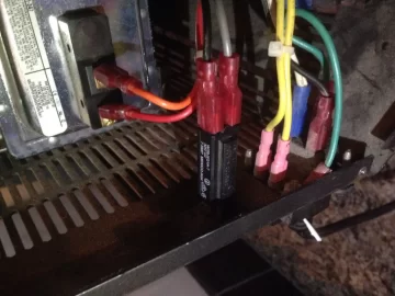

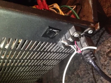

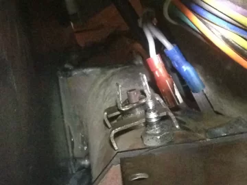

Ok so here are some pics of what I think is the fuse. One pic from the side panel and one from the back. It looks like there is a switch on the back of it, but it does nothing. I can't get it out! He last pic is of the right side panel trying to show the snap disc 3. I disconnected the vacuum hose and unplugged the wires going into the snap disc. I still have not made any progress

The switch on the back that says 7 amp I don't have on my stove. Instead I have the cap that we have spoken about. When was the build date on your stove? Should be on a sticker on the inside of the hopper as I remember.
That switch looks to me to replace the fuse and may very well be a resettable fuse. Do you own a volt meter and know how to use it? If you do, take the wires off the 7 amp rocker switch and see if power goes through it. It should allow power to go through it in one position or the other. If it doesn't, it's bad and needs replacing. If it does make note of the position and leave it there.

That looks more like a circuit breaker to me. It has a current rating, but I see no way to open it up to access anything.

Last image might give a clue as to why that fuse or breaker went pop, igniter connection is crappo.

Looks like the wires from the #3 snap disc to me.
On closer inspection, that might be a fuse holder. You would push in, then to one side (or down) to release the fuse.
It's hard to read, but looks like it has a 32 VDC rating, which would not be used for incoming power, so it may be to protect the control board.
Those circuit breakers are usually push to reset. Nothing comes off or out.

Correct! I said that to indicate there was no fuse inside. Now I see that it's indeed a breaker, from your pictures. The OP's apparently isn't tripped, but it could be defective.
With severe overloads, such as a short circuit, the contacts usually weld together resulting in a conducting condition with no protection against future overloads and no indication of a problem. They are cheap, convenient and unreliable. I dislike them almost as much as I dislike snap disk thermal switches.

The manufacture date is October 2003. That pic is exactly what that black thing it. Now I know its a circuit breaker. Thanks Harvey. I don't have a volt meter to test anything out. Let me ask this question, the top connection to snap disc 3 appears to be a bit burnt looking. When I took it off the red plastic piece broke free from the connection and it was difficult to remove it from the snap disc itself. If the snap disc is bad, would I get any response when I plug the stove in? Because right now, I plug it in and get nothing. I took the control box out, which is new this season, and removed and inspected the little glass fuse and that looks fine
Yes, that is likely the case but I don't have a picture of the insides of that particular stove and no reference for the angle of the shot, that looks like the source of the breaker going none the less.
