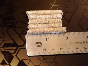

I am on my fourth year with my Harman XXV and am using MWP for the first time. Last night I heard the fan going on and off in the middle of the night. The stove was going out. On inspection I realized the pellets were not dropping. I thrust my hand trough the pellets and they started dropping. The stove started back up and no more trouble so far. That was the very first bag.
I then noticed that there were a small percentage of really long pellets in the hopper. Some were nearly two inches long. The long pellets caught just right and dammed up so no pellets reached the auger. Bought the Maine Wood Pellets from Tractor Supply and they seem nice besides this concern. Anybody else run into this problem? Photo attached.

Nope, a certain percentage of long pellets is allowed by the standard, and just so you understand I'm on bag #19 of a ton of this spring's MWP.

The standard allows up to 1% of the pellets to exceed 1.5 inches in length.

I just got off the phone with Scott from MWP. I found a bunch of long ones and pulled them out for him. He is going to swing by my place and pick them up so they can check them out.
We were jamming 2-3 times a day. Long pellets were clogging the drop tube between the upper and lower augers. It was pretty easy to free up but then one day we got a monster jam that took me about an hour to free up. That same day, I talked to both Englander (thanks Mike) and MWP (thanks Scott) and both companies were very patient and helpful. The only thing I have changed since then is I throw the bag on the concrete floor in the basement a couple times before I open it up, in an effort to break up some of the bigger ones.
Ever since that one big jam, we haven't jammed again yet in a week whereas before we were jamming multiple times a day...so I think my problems are mostly solved at the moment. I am thinking that either the drop tube was partially clogged and it finally came undone, my beating up the bag actually helps or there were manufacturing burrs in the tube that got worked off. Or a combination of all 3.

Yup Cincinnati Kid, that is what it is called and according to the manual for the stove the OP has, that stove can not handle pellets longer than 1.5 inches, unfortunately PFI premium standards allow up to 1% of the pellets to exceed 1.5 inches. So if a long pellet presents just right all kinds of not so fun things happen.

Just to follow up on this, it appears that I got a bad ton. I bought 4 tons of MWP this fall. I've sampled several bags off of 3 of the tons and had no problems with pellet length. The 4th ton is loaded with bags that have 2-3 inch long pellets in them. My stove has a really hard time with these. It is a dual-auger stove and the long ones get stuck in the drop chute between the two augers and it ultimately results in an upper auger jam because it gets backed up at the drop.
They have been very accommodating to my problem. At first, I'm not even sure that they believed me when I said I was finding pellets over 2 inches long. They said that I was the first and only person to contact them about the issue. But, I saved some and gave them to them so the proof was in the pudding at that point. Obviously, if other people are posting the same thing on this forum then it is not just me.
