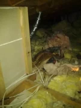

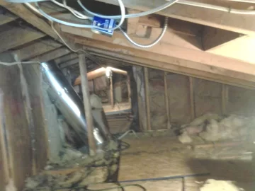

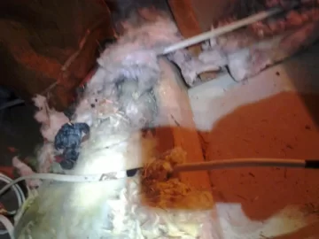

Here the squirrels had made a nice nest. Chewed up insulation, wires and wood.

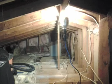

This here is just a mess. Bathroom is below, the vertical sheet rock is the bathroom skylight. I figure it was added at some point but the contractor didn't bother to frame it correctly or insulate it properly. Then add electrical work along the way which accounts for insulation being tossed aside and not replaced properly.

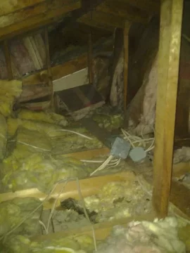

Longer view of attic.
[Hearth.com] My Attic Insulation Experience (in process)

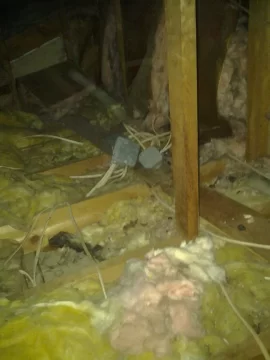

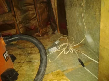

I started by getting some ripped sheets of OSB up there to make it easier to move about. It is still difficult to crawl about because of the low pitch of the roof. Only 38 inches tall at the tallest part. Bought a P100 respirator, well worth it, 2 layers of old sweats, a fleece and a hat.
Started by cleaning out 7 trash bags of torn up fiberglass insulation.

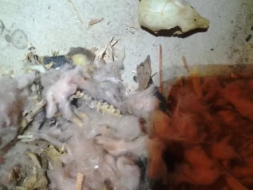

Found the squirrels too.

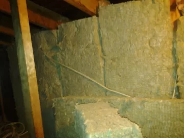

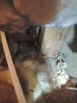

Cleaned out some of the mess and put in some Roxul R23 insulation. So far I really like it. Fits tight between the lumber, easy to cut and tougher than I expected. When compressed, it bounces right back and has a lot of push back.
[Hearth.com] My Attic Insulation Experience (in process) [Hearth.com] My Attic Insulation Experience (in process) [Hearth.com] My Attic Insulation Experience (in process) [Hearth.com] My Attic Insulation Experience (in process) [Hearth.com] My Attic Insulation Experience (in process)

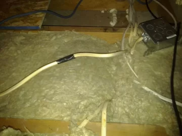

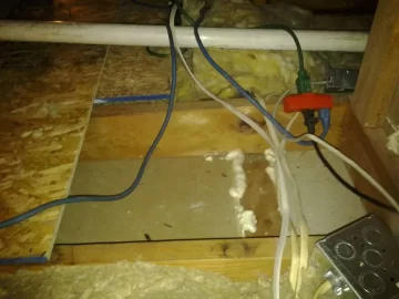

Also sprayed insulation foam at the top of the wall plates, and any ceiling fixture I could find - electrical wire holes too.
