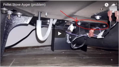

I think you *might* (I'm not 100%) have a defective auger tube that is from the first run of the Breckwell SPC50 pellet stoves. I believe so because of the mounts circled in red below. I had a similar problem where the motor sounded like it was about to die pushing the pellets through. I got a replacement from Breckwell, and my resistance issues improved dramatically, the new one did not have the mounts shown.
It is also possible I am wrong and it might be the motor.
You may already be doing this, but try mostly filling an empty soup can with pellets. Pour a tsp. of vegetable oil in and then stir it around. Use these pellets when you start the stove to help lube up the auger. Also, my defective auger REALLY hated softwood pellets. It wasn't perfect my any means with hardwoods, but there was less resistance.
When I originally had problems, I spent some time working with the guy who originally designed and manufactured this stove. He was incredibly helpful, and worked with Breckwell to let them know that there were resistance issues with my stove, which was one of the first stoves made.
