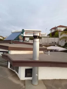

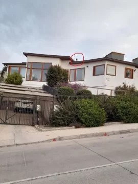

Thank you much for yr ideas and questions. I will try to get a better picture of the tag. And, I am attaching pictures of the top of the flue and cup. One shows the top from the other side of the street (marked in red). It looks tiny. The other shows the detail, picture taken standing on the roof. Yes, house is on a hillside.
Well, in fact we haven't make any main mod to the house since last winter. Moreover, our house has several vertical ventilation windows that are almost always open. They are 1,5 m long and 15 cm wide. It is difficult we have them all shut. But I will make the test you suggest anyway.
One difference is present: normally at this season (down) we used to have rain and wind. It was heavy sometimes. However, this year we have not rain nor wind.
Thank you. Best
Thank you. Best
View attachment 294979 View attachment 294980

Well, climate here is variable, from 12 degrees centigrades in the early morning, to 25 degrees today afternoon. But my problem is SOLVED!
What was causing this problem was the cup. It was sitting too close to the top of the flue, leaving only 1 cm of distance. The three legs it has were supposed to be attached to a piece of pipe on top of the flue, kind of a "collar", leaving a free flow space of 5-8 cm for the gases to get out. But, at some moment these three legs become loose and the cup fell down on the collar. I will screw tomorrow.
Originally, the legs were welded to the collar. Maybe the heating and the weather changes took off the welding.
I made a test lifting a little the cup and started a fire. The stove worked perfectly well, with a lot of draft, as it used to do.
Mistery solved, thank you much for all yr help. Sorry for making you think so much and for all your advice. Looking this from a positive side, this cause of lack of draft may serve as new experience for all.
Best

That's great news. I was certain that the issue was not the air intake. To repair the legs on the cap, drill holes and either screw or pop-rivet the legs in place. Use stainless steel screws or pop-rivets.
