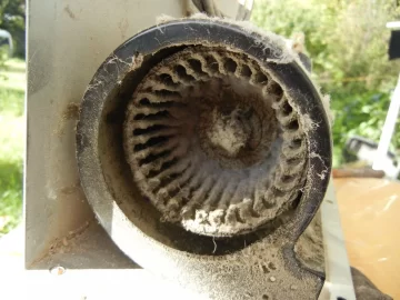

Fan may need a cleaning and oil. If the motor gets dust bunnies it overheats and shuts down also dry bearings will act the same way.
I bought a used Drolet and I'm sure the guy never cleaned the motor properly. What I thought was a foam filter was a gross combination of dust,oil and dirt. I had to get in there with a pick and tenderly pull it all out.
This fan has issues
