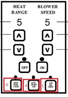

Thanks; for some reason the problem seems to have sorted itself; thank goodness. I still don't understand the numbers that you all mention when talking about the 3 bottom buttons but maybe I'll figure it out some day. I wish I could find a video of an explanation.
See pic below ...... each one is set with a number, press each one of the buttons outlined in red as shown below, a number will be displayed for each button.
To change the number you press the up or down button under that number.
The defaults are 6 - 4 - 1 as shown below.
