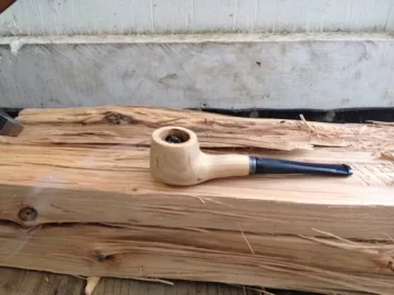

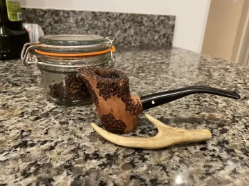

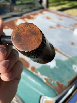

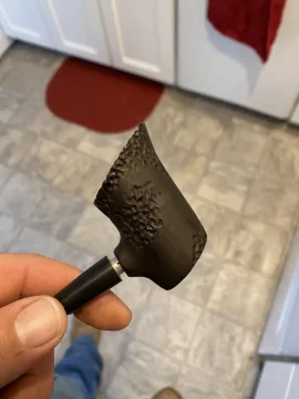

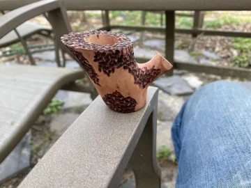

Do any of you carve? Really thought about trying it out
This one actually came from a piece of hickory from the wood stack. 3BAFA384-C920-47A5-BF90-AECBEE2343AC.jpeg
Then one from a briar wood block.
C711743F-DE06-4353-9432-42C34E6C6255.jpeg 6EFC715C-DBDC-44C5-B9A7-7344B62A8140.jpeg

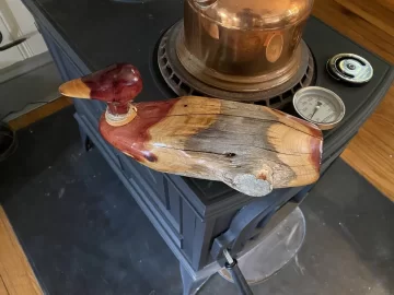

Had a small fire in the stove yesterday evening. Went out and chopped the top off an old cedar post about 4:00. Sat by the fire and had a duck by midnight. Put on some clear coat this morning.
Disclaimer: there was a rough chopping with the axe to get the rough angles, and the head was roughed out on the bandsaw and grinding wheel. Still, a fair about of knife work and sandpaper.
It’s a little bit chicken necked and too round in the head, but I have some better ideas for the next one.
