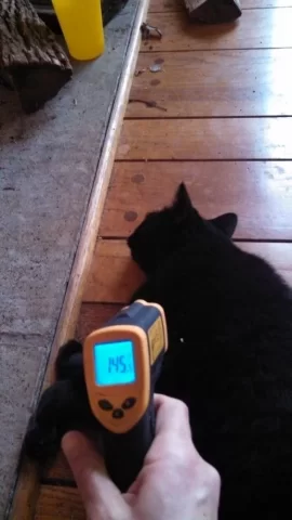

Gotta get to 400 before that cat will ignite.
Yeah, but even then, they usually have too much moisture content to burn well.;)
Our fuzzy old devil likes to lay beside the hearth pad, and somehow puffs out his fur somewhat to absorb the heat? better.
